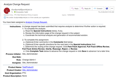

Email notifications body is empty on workflows
RG_10753677

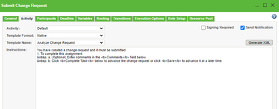

I had few variables, which were set to visible on an activity, and not visible on the other one. That caused a null value, which in-turn wiped out the entire 'body' of the html/email.

No, I am using the 'Send Notification' checkbox in activity.

Hi @RG_10753677
It seams that email is checked by some software and adds the bottom description ... "The information transmitied by"....
I would say that the sw riped out the body for security reason.
If Iam right you need  to contact your IT to solve the issue.

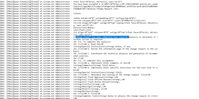

what @HelesicPetr says makes totally sense,if you want to inevtigate from the windchill side anyway
you may enable below logger to TRACE,steps in attached video
wt.mail.EMailMessage
 you should then then see the body sent by windchill in the logs :

It is not happening for all emails. Some emails are working fine, some don't.
the logs for the email that works, you can see the html

2023-09-28 11:10:49,467 INFO  [EMailQueue.SchedulingThread] wt.system.out wcadmin - <A href=3D"https://windchill-dev.xyz.com/Windchill/ptc1/process/info?oi=
2023-09-28 11:10:49,467 INFO  [EMailQueue.SchedulingThread] wt.system.out wcadmin - d=3DOR%3Awt.workflow.engine.WfProcess%3A16446970&amp;u8=3D1">xyz Engine=
2023-09-28 11:10:49,467 INFO  [EMailQueue.SchedulingThread] wt.system.out wcadmin - ering Change Request_ECR-00220</A>
2023-09-28 11:10:49,467 INFO  [EMailQueue.SchedulingThread] wt.system.out wcadmin - <BR>
2023-09-28 11:10:49,467 INFO  [EMailQueue.SchedulingThread] wt.system.out wcadmin - </td></tr>
2023-09-28 11:10:49,467 INFO  [EMailQueue.SchedulingThread] wt.system.out wcadmin - </table>
2023-09-28 11:10:49,467 INFO  [EMailQueue.SchedulingThread] wt.system.out wcadmin - </body>
2023-09-28 11:10:49,467 INFO  [EMailQueue.SchedulingThread] wt.system.out wcadmin - </html>
2023-09-28 11:10:49,467 INFO  [EMailQueue.SchedulingThread] wt.system.out wcadmin - .
2023-09-28 11:10:49,545 INFO  [EMailQueue.SchedulingThread] wt.system.out wcadmin - 250 2.0.0 OK <64658578.588.1695917449452@hyleslzwndchdev.xyz.LOCAL> [Hostname=1234567.namprd19.prod.outlook.com]
2023-09-28 11:10:49,545 INFO  [EMailQueue.SchedulingThread] wt.system.out wcadmin - DEBUG SMTP: message successfully delivered to mail server
2023-09-28 11:10:49,545 INFO  [EMailQueue.SchedulingThread] wt.system.out wcadmin - QUIT
whereas, for the email that the body was empty, you can see in the logs there is no html.
2023-09-28 11:11:03,222 INFO  [EMailQueue.SchedulingThread] wt.system.out wcadmin - Content-Transfer-Encoding: 7bit
2023-09-28 11:11:03,222 INFO  [EMailQueue.SchedulingThread] wt.system.out wcadmin - .
2023-09-28 11:11:03,300 INFO  [EMailQueue.SchedulingThread] wt.system.out wcadmin - 250 2.0.0 OK <796252988.589.1695917463222@hyleslzwndchdev.xyz.LOCAL> [Hostname=123456789.namprd19.prod.outlook.com]
2023-09-28 11:11:03,300 INFO  [EMailQueue.SchedulingThread] wt.system.out wcadmin - DEBUG SMTP: message successfully delivered to mail server
2023-09-28 11:11:03,300 INFO  [EMailQueue.SchedulingThread] wt.system.out wcadmin - QUIT
