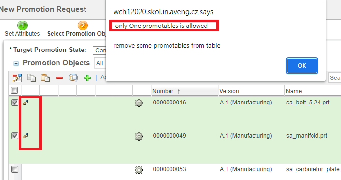

Hello everyone!
I've made a custom validation class on Promotion Request Wizard to allow only 1 Object to be promoted.
On my implementation of DefaultUIComponentValidator, the method performFullPreValidation(UIValidationKey arg0, UIValidationCriteria arg1, Locale arg2) throws a WTException when validation not met the requirements, but the message on Exception do not show to the final user, just appear on console.
What's happening? Am I missing something? What's the correct way to display exception message to the final user through alert dialog?

Hello @JD_8489700 ,
I try some ways how to achieve what you need but I don't think that it is possible by that Validator. May be I am not right.
I found the solution but is is not recommended because .I change js script directly in the OOTB js file.
That means every update/upgrade you have to change that js file. (i guess that there could be better implementation 😄 )
But I couldn't find better way now how to disallow promotes just one object even there are more. (I could not find the promotable objects in a NmCommandBean there is just selection... )
you have to modify JS script with following code
the file is in <WTHOME>\codebase\netmarkets\javascript\promotionRequest\promotionRequest.js
find a row with function validatePromotionTable: function(wizardAction) {,,,,,
in the end is a row with the code
return PTC.promotion.validateForDuplicates(allOids, promotedOids);
before this row put following code that controls how many promotables are set to promote
            if (promotedOids.length !== 1 ) {
                JCAAlert(
                    "only One promotables is allowed"
                    + "\n\n"
                    + "remove some promotables from table");
                return false;
save the file, and restart Windchill.
clear a explorer cache or use CTRL+5 to load new js script.
{in some cases the restart is not needed. }

throwing an exception is not the right way. You need to return a UIValidationResult with a UIValidationStatus.DENIED.  Page 426 of the customizer's guide has an example.  There you can provide a message back to the user.

Hello @JD_8489700 ,
                JCAAlert(
                    + "\n\n"
                return false;
PetrH
Thanks, @HelesicPetr , this is it!
Thanks for your time!
