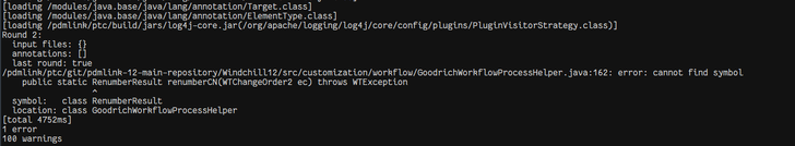

I added in the line to setup Windchill shell environment, but am still getting class not found exceptions when compiling. I tried adding my jar files to the classpath when compiling, which is when I noticed that each file was separated by a string, when they should have been separated by a colon.
After putting all the the jar file paths into a string variable (separating them by a colon) I'm still getting Windchill class not found errors.
Here's what my jar_files_str variable looks like: (full paths of jar files separated by ':')
Current bash file:
errors still getting compiling:

I'm close to solving this, but not quite. I was able to add the OOTB classes to my classpath with this: CLASSPATH=/pdmlink/ptc/installers/wc12_codebase/wc12_codebase:/pdmlink/ptc/build/jars/*, the issue is I also need custom classes to be referenced in the classpath as well. I tried setting the classpath /pdmlink/ptc/build/jars:/pdmlink/ptc/installers/wc12_codebase/wc12_codebase:/pdmlink/ptc/installers/custom/customization, with the custom class files being in customization. This did not work. I also tried making a copy of wc12_codebase, and copying the classfiles to there, so classpath=/pdmlink/ptc/installers/wc12_codebase_copy/wc12_codebase:/pdmlink/ptc/build/jars/* This too did not work. RenumberResult.class exists in the custom/customization directory, So I am unsure why the compiler isn't able to recognize this.
