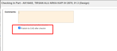

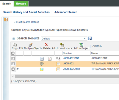

I can reflect the change made in the wtpart data to the cad data by selecting the "publish to cad" option when checking in. When I want to check more than one wtpart data in the advance search section of this method, that option does not appear. How can I do this?

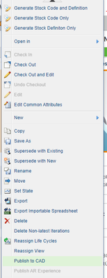

If it is impossible to bring the "publish to cad" option on the check-in screen, can I bring the "Publish to cad" button in the actions menu on the details page to the advance searc actions menu?

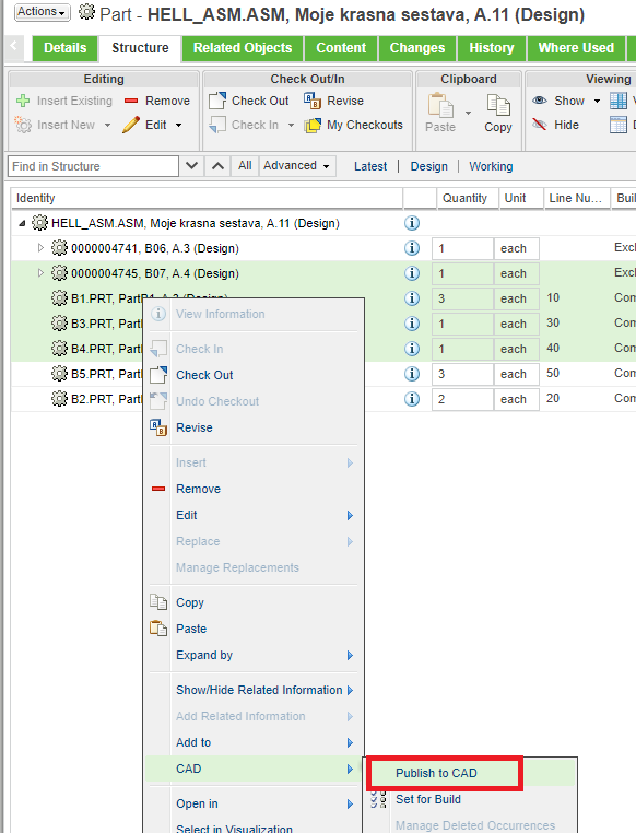

Put all WTParts to a temporary WTPart structure and do the action from that structure. After finish delta the temporary WTPart

Can't I bring this feature to the browse menu, I need to do this for different codes

The menu function is written for GWT structure so You can not to move it to different place as is.
You can just write own function that do same action.
