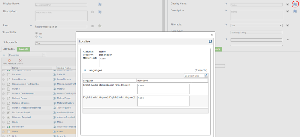

There was also a question unrelated to the topic: "How do I change the display of table column names? I use Cyrillic ( Russian names). For example, "Name" is already displayed as a "Обозначение", but this has already been done before me, I do not understand how to do this with other columns.

Hi VladiSlav,
Have you tried changing the localization in Type and Attribute Management?
That's what is driving the names of most of the columns:
Kind regards,
Dmitry.

3)Change the localization in Type and Attribute Management.
