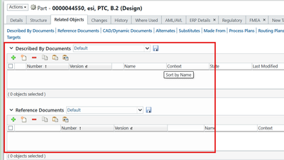

with item do you mean a part ? how documents are linked reference or describe link ?

Yes, documentation linked to a part. I don't know when I get the part how to list the linked document.

from the related objects tab you can see if its describe or reference doc :

Exactly it s where the documents are but I don't know how to get this link when I send a request throught the REST API. Do you have any idea ?

Ok thanks a lot I test it and come back to you
The solution you proposed works great ! Thanks a lot
Do you know if we can get the same result with REST API instead of ODATA ? (http://<host name>/Windchill/servlet/rest/)

Hi Fede, it is almost what I was looking for, but I thought to get an equivalent of this ODATA http request using the REST API /Windchill/servlet/rest/ ?
Thanks in advance,
