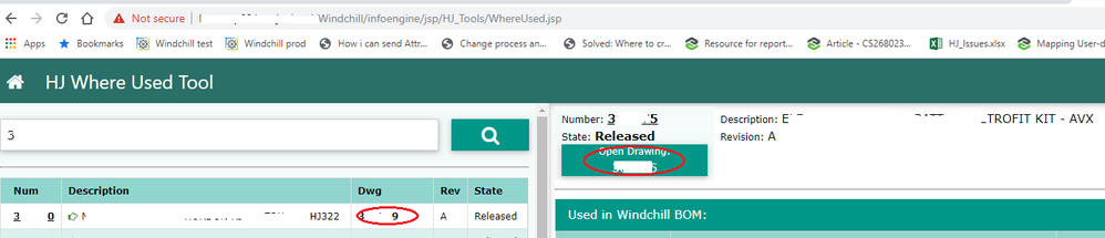

DmitryC
(To:nbojcetic)
Hi, nbojcetic.
You can also put any JSP file into the Windchill\codebase\infoengine\jsp folder and run it without any additional setup.
There you can create a simple interface and use rest services to fetch any data, including the pdf of drawings available to the currently logged-in user.
Here I made a tool that checks part usages across multiple databases and gives the user an option to download drawing PDF.
Kind regards,
Dmitry.
Hi Dimitry,
very interesting solution, thank you. I will try that also and see what suits students needs better. The main drawback of this approach is authentication (the user, in our case student, have to login, using form login, to the Windchill) in the case of servlet we can use "dummy" account to access the servlet and the "real" account to fetch data from Windchill.
No, I am struggling with servlets 😞
Best regards!
Nenad
