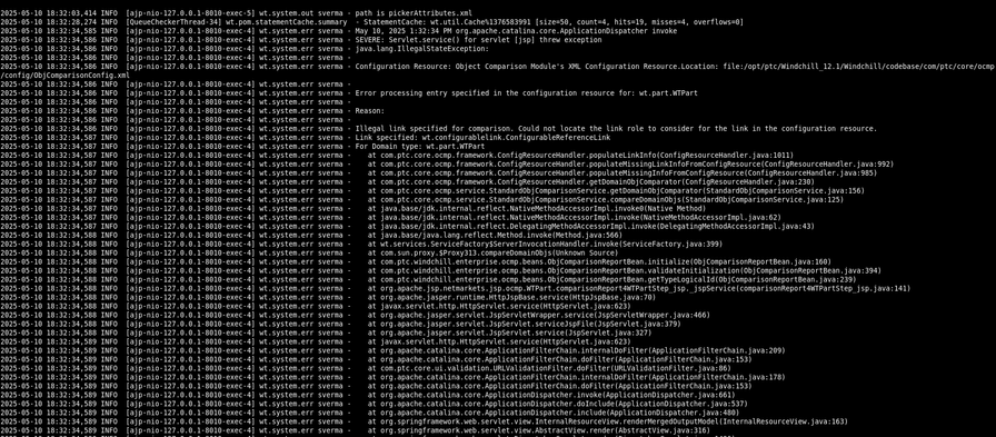

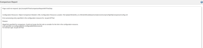

I made the changes you mentioned above, but I’m encountering an error
May 10, 2025 1:36 PM UTC
I have added the entry as well. I am attaching a screenshot of the logs for your reference. Kindly assist me with this issue at your earliest convenience.
