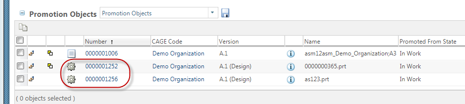

Here is a precise code (highlighted in red) for your reference. Thought I have demonstrated it for wt.part.WTPart type, you can use wt.epm.EPMDocument for EPMDocument type.
wt.fc.QueryResult qr= wt.maturity.MaturityHelper.service.getPromotionTargets(pn);
while (qr.hasMoreElements())
	wt.fc.WTObject  obj =(wt.fc.WTObject) qr.nextElement();
	if(obj instanceof wt.part.WTPart){
		wt.part.WTPart prt = (wt.part.WTPart) obj;
		System.out.println("****** " + prt.getNumber());
// Add you logic here } }
Output:
I hope it helps you.
Shirish
