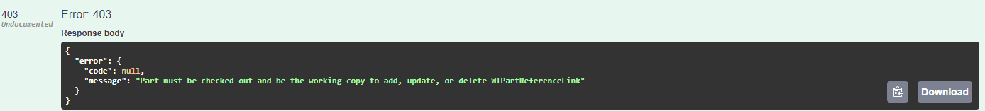

Use Case: Using Windchill REST Services to creating a Referenced By link between a Part and a Document
Description:
I have followed this guide to successfully create a customization to create a WTPartDescribeLink using WRS: https://www.ptc.com/en/support/article/CS285572?source=search
The guide also mentions how to apply the same steps for WTPartReferenceLink, but I am receiving an error and would appreciate some guidance.
URL: POST https://mywindchill.portal.ptc.io:8443/Windchill/servlet/odata/ProdMgmt/Parts('OR:wt.part.WTPart:226444')/References
    "ReferencedBy@odata.bind": "PTC.ProdMgmt.CustomCompanyParts('OR:wt.part.WTPart:226444')",
    "References@odata.bind": "PTC.DocMgmt.Documents('OR:wt.doc.WTDocument:226427')"
The error:
    "error": {
        "code": null,
        "message": "Unable to create entity - Cannot cast wt.doc.WTDocumentMaster to wt.vc.wip.Workable"
I would really appreciate some help resolving this issue.
Attached is my code for this, which was uploaded to "/codebase/rest/ptc/domain/ProdMgmt/v7/entity". I took the working copy used in the tutorial for PartDescribesLink and modified it for this. I must be missing something!
Part of my struggle is that I do not know how to troubleshoot this. I attempted to add logging statements following this guide like so:
var mylogger = log4javascript.getLogger("PTC.mypackage");
mylogger.trace("...");
However, this returns the error "log4javascript is not defined". I suspect there's more to do than what the guide says. I feel like I'm flying blind, I am editing some code with Notepad++ and having to restart the server takes 15 minutes anytime I want to test something.
Perhaps this is an easy fix, but I looked at other related topics for my issue, but no resolution was posted, so any additional help would be very much appreciated!

Now you can hit this endpoint:
POST /ProdMgmt/Parts('{PartId}')/References
    "ReferencedBy@odata.bind": "PTC.ProdMgmt.MyCustomPartEntity('{PartId}')",
    "References@odata.bind": "PTC.DocMgmt.Documents('{DocumentId}')"
You can add it to your CCD package by putting the files in this big nested folder structure:

I didn’t try the code but did you change the preference Part To Document Association Logic.
CB_12625553
(To:rhart)
I have not, where would I find that?
In Windchill > Utilities > Preferences, I think it needs to be set to Yes

Logging in WRS extensions (javascript files) can be done as follows:
var LogManager = Java.type('wt.log4j.LogManager');
var Logger = Java.type('wt.log4j.Logger');
var logger = LogManager.getLogger("rest.custom.domain.mycustompackage");
logger.debug("CUSTOMIZATION START ...");
With Windchill REST Services 12.1.2.14, the Product Management v7 domain:

Hi, I am trying to implement this. After putting the files, I am trying to make the request. I checked out the Part before making the request. Even with checked out part I am getting the error code 403 with following response body.
{  "error": {    "code": null,    "message": "Part must be checked out and be the working copy to add, update, or delete WTPartReferenceLink"
Also I used the request body as following
"ReferencedBy@odata.bind": "PTC.ProdMgmt.MechanicalPart('OR:wt.part.WTPart:349320081')",
"References@odata.bind": "PTC.DocMgmt.Documents('OR:wt.doc.WTDocument:349319669')"
Is there anything similar you have faced. I would be grateful for any help or suggestion. Thanks

Hello @MalteSiefkes, Yes, I am using the OID of the working copy and still getting the response
we are on Windchill REST Services 13.0.2.3, and in this release, this functionality is not available; therefore, it should be implemented. For upgrading to Windchill latest version I am not sure what the consequences will be. Therefore, I am trying to implement this into the current version, and any hints or help in this regard will be appreciated. Thanks
Hi @MalteSiefkes, thanks for the suggestion. I spent some time with the script above and successfully implemented the functionality.
