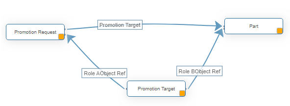

Personally, I would recommend you to start with Query builder.
It will allow you to visually build the required objects and their relationships:

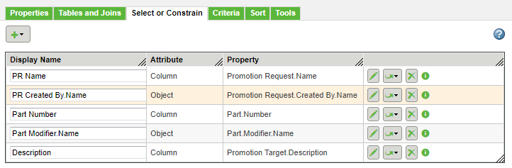

Define all the fields you want to get from those objects:

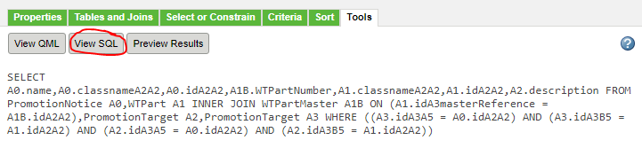

And then have a peek at the SQL query that builds the resulting table:
That should give you a good start.
