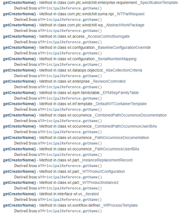

@HelesicPetr , my bad. I saw Created in the list and mistook for Created By. Would the security logs be able to retrieve this information? BTW, this is all the interfaces that have getCreatorName as a method:

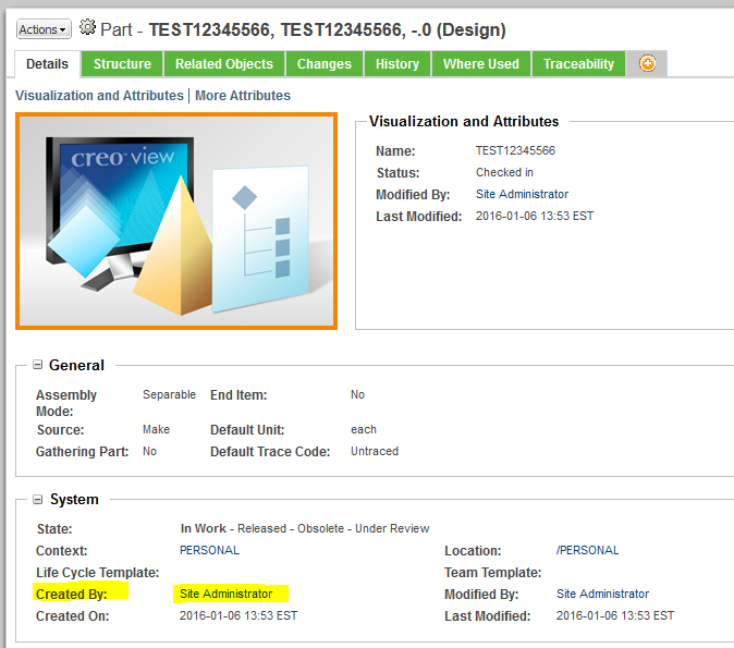

That doesn't seem right.  The WTParts in my system all show 'Created By'.

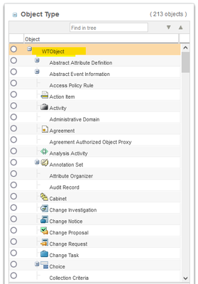

I ment root type WTObject does not contains that info
Only subtypes do

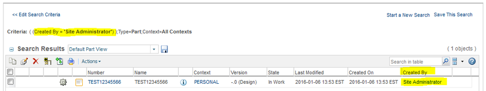

I think I might have misunderstood.  If the question is really about who created every possible object in the entire system, then my response was probably not correct.  I'm not sure Windchill even stores who created every single object.
Couldn't you just do an advanced search? Select the relevant types, then set the criteria to be be Created By user.
