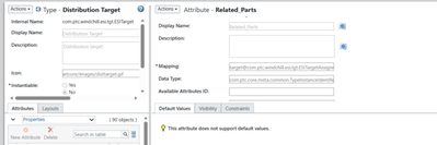

we can define an alias attribute on DT type with mapping target@com.ptc.windchill.esi.tgt.ESITargetAssignmentLink~releasableObject^wt.part.WTPart
but it will show all parts

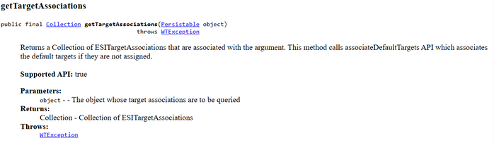

com.ptc.windchill.esi.tgt.ESITargetUtility.getTargetAssociations(Persistable object)
