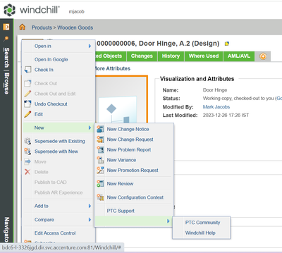

I have created a new submodel under "New" menu and want to give it a display label.

Do I need to define that somewhere? My label looks empty-

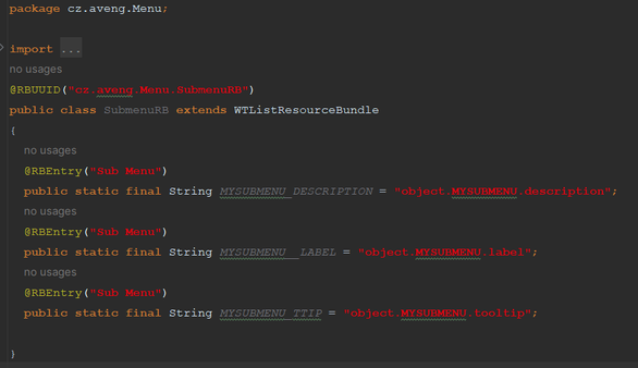

Resolution
The rbInfo class has to have string "RB" in the end of the file name.
After compilation and restart the name is shown.
I also define the resourceBundle in the custom-actionModel.xml
