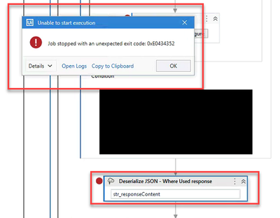

To add further, if I didn't add the query 'ptc.search.latestversion=true' in the API request from Postman I get the below response:
API response when ptc.search.latestversion=true is not addedAPI response when ptc.search.latestversion=true is not added
Due to the exceeded response size I need the child level latestversion response. Sometimes while deserializing the json with exceeded response size, the deserialize package throws an unknown exception:
I tried applying the latestversion in $expand query but it throws an exception. It will be helpful to get the latestversion query. Thanks in advance.

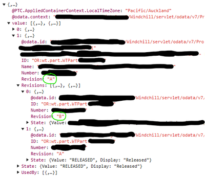

I'm using a workaround for that - expand all the revisions for Where Used parts:
https://windchill.server/Windchill/servlet/odata/ProdMgmt/Parts('OR:wt.part.WTPart:123456789')/UsedBy?$select=Number,State,Revision,Name&$orderby=Number%20asc,Revision%20desc&ptc.search.latestversion=true&$expand=UsedBy($select=Number,State,Revision,Name),Revisions($select=Number,State,Revision)
Then I compare the resulting revision with latest revision:
Unfortunately, I'm not sure how to make it work when you expand it for multiple levels ($expand=UsedBy($levels=max))
