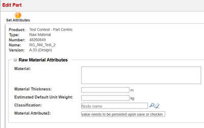

Use Case: I have a custom String attribute on WTPart, and need a data utility where users can edit the attribute value and check-in the part. How to persist the value entered by User in EDIT UI and save it?
Description:

This is the custom Data Utility I have which is registered correctly to the Material Attribute2, and the value entered there is not being saved. I'm using OOTB edit form processor.
public class MyCustomDataUtility extends DefaultDataUtility
	private static Logger logger;
	static {
		try {
			logger = LogR.getLogger("MyCustomDataUtility");
		} catch (Throwable throwable) {
			throw new ExceptionInInitializerError(throwable);
	@Override
	public Object getDataValue(String component_id, Object datum, ModelContext mc) throws WTException
		Object result=super.getDataValue(component_id,datum,mc);
		if(ComponentMode.VIEW.equals(mc.getComponentMode(mc.getDescriptor())))
			  return super.getDataValue(component_id, datum, mc);
		else if(ComponentMode.EDIT.equals(mc.getComponentMode(mc.getDescriptor())))
			logger.debug("EDIT Mode");
			TextBox tb = new TextBox();
			tb.setId(component_id);
			tb.setName(component_id);
			tb.setWidth(40);
//			tb.setValue("this has to be value what user enters in the EDIT UI");
			return tb;
		return result;
I'm using OOTB form processor with a custom string attribute on the WTPart.
Your observation is indeed correct. I replicated the data utility and found out similar behaviour. I tested also at CREATE page and the behviour remains same. The OOTB form processor is not persisting the value after create or checkin and the DU is only acting as data display on CREATE and EDIT pages. This was not the case in previous releases. Maybe you can open a ticket with PTC. In the mean time, I will also investigate from my side if anything has been changed from 12.0 or 12.1

Hi @11025060
If you use own data utility to show the edit column and you define the datautility information correctly,
then the wizard save the information to the database without any additional customization.
If you do not use ootb edit wizard, then you have to write own code to save the value to the database.
All methods how to achieve it is described in the Windchill catalog
https://serverAdress/Windchill/app/#netmarkets/jsp/componentCatalog/wizardComponent.jsp
