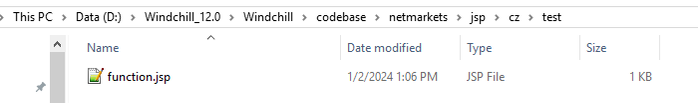

Place your jsp file to windchill codebase netmarkets folder and just run it from URL address
https://server/Windchill/app/#ptc1/netmarkets/jsp/cz/test/function.jsp
