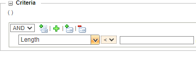

Im working on a scenario, where for a given attribute(eg,status), im using the iba name 'status' with the value anything less than the value 3, i wanted to fetch all the wtdocs with the attribute value<3. Can anyone guide me thorugh please?

If the IBA has been added to your Document type, it should be accessible for the search configuration. You just need to add that IBA as a criteria. You also need to make to that only documents are selected in your Type section. That exposes the unique attributes. Lastly, when you get your results, under actions in search results should be an option to download all as a zip file.
