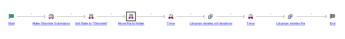

I need some help. I created a relatively simple workflow (reused from another workflow we have) that takes a file, changes the state to Obsolete, moves it to a separate folder and starts a timer. After the timer is done, an activity is launched asking an Assignee to take some action. When that's completed, another timer starts followed by another activity (same as the first one) and then the workflow ends.
There are no loops in the workflow. There's barely any code! The only code that exists is the "move file to folder" java code.
Somehow every time I go to initiate this workflow it initiates and then continues to do so on its own until i disable the workflow template. Now that I know to look for this, I normally catch it after it's only initiated about 200 times or so. The issue is also that the activities sends an email and the first time this happen, Windchill sent me 1800 emails before I was able to shut down the workflow.
Am I missing something easy here? Where else should I look to see what's causing this infinite loop?

In the workflow template, what was causing the infinite loop was the initial "Set state" robot. The action that kicked off the workflow is a "Set State" from any state to a resulting state of "Obsolete". In the workflow, the first set state change is on that PBO to "Obsolete" so the workflow gets re-kicked off.... forever and ever.
PTC Tech support (Aniket Davkhar) found this and pointed it out. Removing any set state robots from the workflow is the solution since the initial "set state" action puts the PBO into the desired state as is.

This is the workflow:

If you have copied a section of the workflow, it may not look like a loop but it may act like a loop. Have you also tried assigning the first action to a role?

have you checked if the Obsolete state has the same workflow process defined in the Life Cycle template?
If this is the case, and you are doing a Set State to Obsolete in your workflow, it can be launching a new worklow instance each time.

I had a call with PTC regarding this and we ended up adding a second state (something else) right after the state is changed to Obsolete. This didn't change the "death spiral".

If you only have 1 state in your lifecycle template, why do you have a set state robot in the workflow?
I think that you can remove the set state robot and probably that will solve your issue.

There are multiple states in the template. I'll clarify: the "second state" was something PTC recommended I add just to go from Obsolete to something else. That something else is my second state and was intended to be just a means of getting the PBO out of the Obsolete state since the theory was that was causing the loop.

Glad it's solved.  May be misleading to admins reading this to make the statement to stay away from set state robots.  Either:
- use multiple workflow processes, each mapped to a different state, and none with set state robots, OR
- use a single workflow process mapped to the first state, and lots of set state robots (will never cause an infinite loop)
The first was very common and recommended in early Windchill days; the second is far more common now.
Dobrisa
(To:MikeLockwood)
Correct. I'm not saying that there shouldn't be "set state" robots used in the workflow. The takeaway for me was that "set state" action in Windchill will already set a state I want. If, after that, in a workflow I have a "Set State" robot that sets the same state again... there will be trouble.
