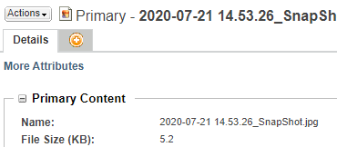

Hi @AdamElkins
The interesting thing is that both URLs work in my system.
Windchilll 12.0.2.7
First is generated by HelesicPetr_0-1701760518231.png on a detail page of primary content or detail page of wtdocument
I don't know a source for the second URL but if I use ida2a2 for aplicationData and WTDocument in my system, it works from webbrowser.
PetrH
