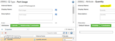

Is it possible to modify part usage attribute (Quantity) without creating a new iteration of the parent or doing a check-out/check-in?
I have the following code to modify "findNumber" which is also a usage attribute. Please provide your suggestions.
QueryResult qr = WTPartHelper.service.getUsesWTPartMasters(parentPart);
while (qr.hasMoreElements()) {
WTPartUsageLink ul = (WTPartUsageLink) qr.nextElement();
WTPartUsageLink usageLink;
PersistableAdapter obj = new PersistableAdapter(ul, null, null, new UpdateOperationIdentifier());
obj.load(attName);//attName="findNumber"
obj.set(attName,attValue);
usageLink = (WTPartUsageLink)obj.apply();
IBAValueDBService ibaserv = new IBAValueDBService();
ibaserv.updateAttributeContainer(usageLink,((DefaultAttributeContainer)usageLink.getAttributeContainer()).getConstraintParameter(),null,null);
PersistenceServerHelper.manager.update((Persistable)usageLink);

You need to modify your code for
ibaHolder = (IBAHolder) obj.apply();
AttributeContainer partContainerAfterUpdateOfSoftAttrs = new IBAValueDBService().updateAttributeContainer(ibaHolder, obj, null, null);
ibaHolder.setAttributeContainer(partContainerAfterUpdateOfSoftAttrs);
 No need to use "PersistenceServerHelper".
Hello @froussel_fr ,
Thanks for the suggestion. But still I am not able to modify "quantity" attribute of usage link object.
Is there any way where we can modify "quantity" without creating a new iteration?
PFB snapshot. I have tried providing the internal as well.
Florent
(To:hsha1102)
Well, the code you provided was mentioning "find number", didn't pay attention "quantity" in the question.
The quantity being a special field (with consequences on occurrence links), I would suggest to try with
WTPartUsageLink.setQuantity() and then PersistenceServerHelper.
Florent ROUSSEL
www.4cad.ca
Hello @Florent ,
Thanks for the response.
But to modify the attribute with usageLink.setQuantity(), the parent must be in checked out state in order to persist the change which will result in creating a new iteration of the parent part. So I cannot use the solution that you mentioned.
