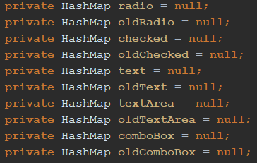

HashMap textArea nmCommandBean.getTextArea()
HashMap checked = nmCommandBean.getChecked(); // if something is not checked it is not included in this Hash
HashMap radio = nmCommandBean.getRadio();
HashMap texts = nmCommandBean.getText();
HashMap comboboxes = nmCommandBean.getComboBox();
you need to process all your inputs from this HashMaps each input should own identification from JSP.
