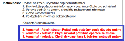

I needed to get comments similar way how you need the votes with users.

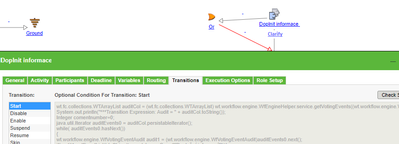

I wrote code for worflow transiction Start where I needed to show to user previous comments of users who wanted more information
I didn't sort the results because they follow that what is first in iterator is last
Code
wt.fc.collections.WTArrayList auditCol = (wt.fc.collections.WTArrayList) wt.workflow.engine.WfEngineHelper.service.getVotingEvents((wt.workflow.engine.WfProcess)((wt.workflow.work.WfAssignedActivity)self.getObject()).getParentProcess(), null, null, null);
System.out.println("***Transition Expression: Audit = " + auditCol.toString());
Integer comentnumber=0;
java.util.Iterator auditEvents0 = auditCol.persistableIterator();
//here I need to know how many times the Clarify transaction is done.
while( auditEvents0.hasNext())
wt.workflow.engine.WfVotingEventAudit audit1 = (wt.workflow.engine.WfVotingEventAudit)auditEvents0.next();
if(audit1.getEventList().toString().equalsIgnoreCase("[Clarify]")) // string name of transation name
comentnumber = comentnumber +1;
java.util.Iterator auditEvents = auditCol.persistableIterator();
String comments = "";
while( auditEvents.hasNext())
wt.workflow.engine.WfVotingEventAudit audit = (wt.workflow.engine.WfVotingEventAudit)auditEvents.next();
System.out.println("***Transition Expression: User vote = " + audit.getEventList());
System.out.println("***Transition Expression: User comment = " + audit.getUserComment());
if(audit.getEventList().toString().equalsIgnoreCase("[Clarify]")){
comments += comentnumber+ ". comment - " + audit.getUserRef().getName() + ": " + audit.getUserComment() + "\n"; // here you can use getEventList()
comentnumber=comentnumber-1;
System.out.println("***Transition Expression: Complete Time = " + audit.getPersistInfo().getCreateStamp());
System.out.println("comments = " + comments);
String special_instructions1 = comments;
 results in a task page in instructions:
