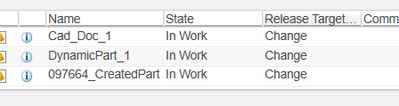

Use Case: Requirement 1) Want to fetch change summary details like On Order, Work-in-Process, Finished, etc. Requirement 2) How to get Release Target or Change Transition details for Objects
Description:
I don't know actually how to use :
1) wt.change2.ChangeRecord2 record = (wt.change2.ChangeRecord2)
2) wt.lifecycle.Transition
HelesicPetr
