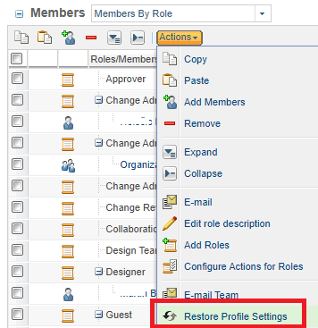

Check the license group if there is not disabled profile with old license
Next try to .reset profile settings on the context
Very often after a upgrade to wch 12+ there is necessary to rearranged the licensees because some are not used anymore for example PDMLink license and so on...

As Petr mentioned it sounds like a profile. You may want to check your profiles to make sure the rename action is visible
https://www.ptc.com/en/support/article/CS61251
https://support.ptc.com/help/windchill/r12.1.2.0/pt_BR/index.html#page/Windchill_Help_Center/profilemgmt/ProfileMgmtProfileEdit.html
I have encountered similar issues while upgrading to wc11.1 and wc12.0. Sometimes there is a funny issue with the std or license profiles that blocks or prevents access to actions. I have seen Set State, Rename and access to view the Supplier list in the past. For each item, I was able to work with PTC TS to get an updated profile XML to load that cured the issue.

Hi @Pushpak
Role base check is checking the license profile, if the action is enabled.
Usually specific check box is not checked for the action.
Check following article: CS362351
