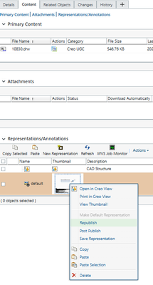

PN_10839578
(To:Dobi)
Thanks for the input and code. I copied your code and did attached new xml file but did republish the file not generating the pdf/step file. Attached copy of xml file. Post publish is not working.
Post Publishing Succeeded with Warnings
Warning: there are no additional files in the representation to post publish

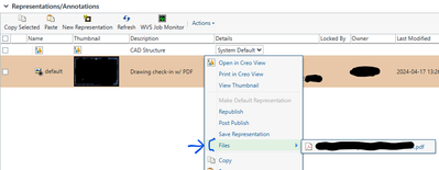

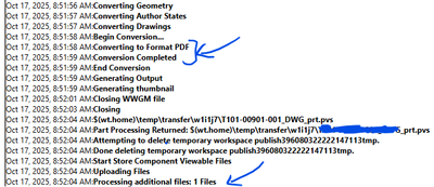

The pdf/step is generated at initial publish. When it's created successfully, you'll see something like this:

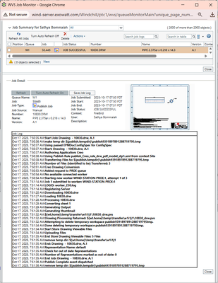

Republish will just rerun whatever was used previously for that representation. It looks like your additional files aren't getting created. What's your WVS job monitor log look like for this?
PN_10839578
(To:Dobi)
Here is my WVS job monitor.
Dobi
(To:PN_10839578)
Your additional files aren't getting created.

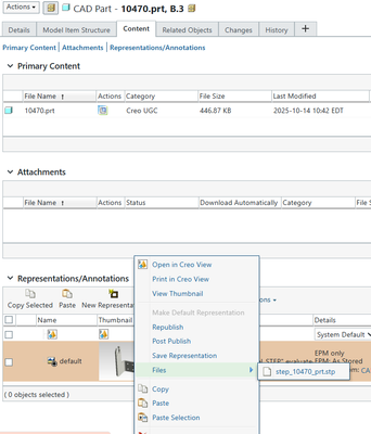

PN_10839578
(To:Dobi)
Here is the example of pdf /step file generated when we do check and check out.

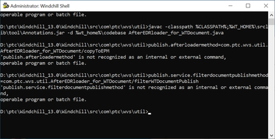

Also I tried to move pdf/steps created to attachment category in windchill. I followed the same steps mentioned in the link provided. the error msg attached below.
Dobi
(To:PN_10839578)
On your 10469.drw and 10470.prt examples, if you republish it ought to generate the same output. That's what republish does.
We have an older rev of the AfterEDRLoader running that had options through wvs.properties to add the pdf/step as attachment. I'll look at the latest version some more.
