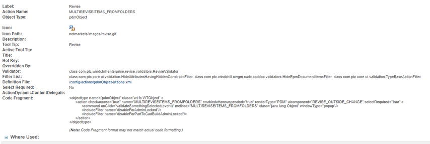

We would like to disable Revise action from Folder Browser's action if certain condition doesn't matches our expectations. It can be achieved through Object's Details page, But couldn't perform the same in Folder Action.
Or else, Throwing explicit exception while revising the object from Folder Browser would also be fine. Please suggest your opinion dear friends!!

You can write own validator and add the validator to the function in customAction.xml
There can be many validators for the function.

Thanks for your suggestion. The concern here is We had extended the ReviseValidator OOTB class for our custom class and chosen the selector of that specific Folder revise action, still it only calls performFullPreValidation method.
On Run-time, so far, it's not possible for us to hide/block the action while revising from Folder browser.

I would suggest to create own validator not extended and configure your validator in customaction.xml
add your validator to the filter element
<action name="MULTIREVISEITEMS_FROMFOLDERS" checkaccess="true" enabledwhensuspended="true" renderType="PDM" selectRequired="true" uicomponent="REVISE_OUTSIDE_CHANGE">
 <command windowType="popup" class="java.lang.Object" method="MULTIREVISEITEMS_FROMFOLDERS" onClick="validateSomethingSelected(event)"/>
 <includeFilter name="disableForAdminLocked"/>
 <includeFilter name="disableForPartToCadBuildAdminLocked"/>
 <includeFilter name="myOwnValidatorRegistredInserviceproperties"/>
</action>

I had attempted this way as well. Since this revise action from Folder Browser had enabled/functioned through OOTB Template Processor. Our validator doesn't have privilege to hide this action at run-time, Hence looking for an alternative way to block/restrict revise action. I hope it helps you for understanding my concern.
Thanks for your help !!! Kindly suggest any approach to throw explicity error/exception/alert message.

If I set my own validator to the revise action in folder, it works.
So you may do something wrong.
here is example of very simple validator if user is admin or not.

If I set the validator (filter) to the revise action. then the revision is shown only for administrators.
and really it works I tested now.
PS: do not forget register your validator in service.properties
