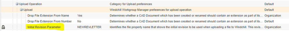

Can Creo utilize the OOTB Windchill property 'Initial Revision Parameter'?
We are using it with SolidWorks to create new family member instances at the same revision as the generic file.

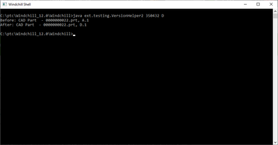

To test I wrote some code I'm running in a Windchill shell.
It's works.
Output is below:
David

My test object IS persisted.  It's an old EMPDoc that I had in the dB.
So my approach would work for you.
