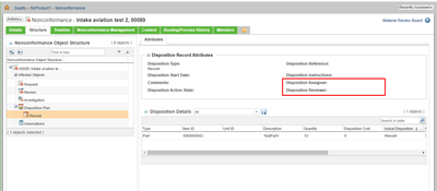

Hi All,
I have created two custom global attributes of type String on Disposition Record and assigned default value
Disposition assignee and Disposition reviewer
But I'm not able to see in UI on Disposition Record Attribute Layout

Thanks @HelesicPetr  for reply.
I set default value and I have created new object still its not visible to me

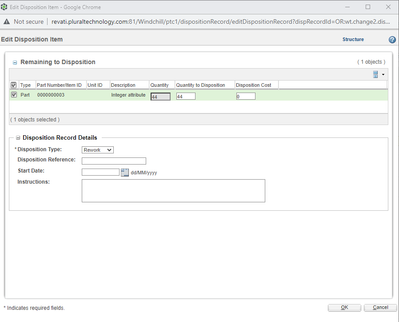

Hi @RS_10128209
The default value is usually populated to the attribute in the creation wizard.
Is the attribute shown in your creation wizard?
PetrH
No the attribute is not visible in creation wizard
HelesicPetr
(To:RS_10128209)
@RS_10128209
So it would be a reason why the value is not shown.
Add the attribute to the creation wizard
