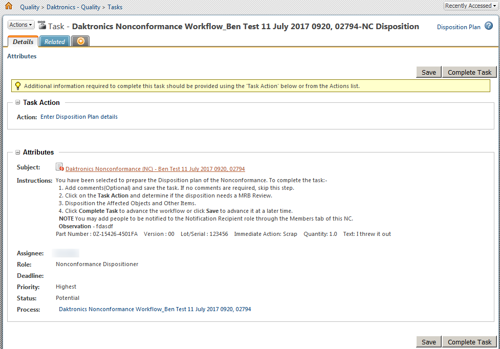

One of the latest requests I have had in the Nonconformance implementation was to get a list of the Immediate Actions taken for each part of a Nonconformance presented in the Nonconformance Disposition task.

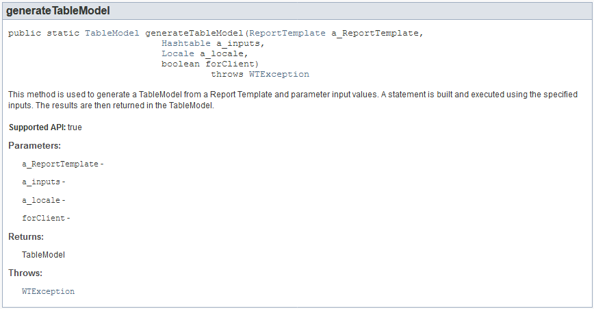

I first started looking at the out-of-the-box Nonconformance reports to get an understanding of the object family structure.  That led me to trying to find the APIs for Nonconformance, didn't find any as there are no such supported APIs documented in JavaDoc.  If I have a report, then I'm getting the information I need.  How does the report present the information?  Can I use the report itself?  My initial path was to get the URL of the report itself and parse the response for the data I needed... what a mess (and points to just how new to this stuff I am).  Then I found ReportTemplateHelper.generateTableModel().  This was my ah-ha moment.  I can build a report template that has all the information I need for a task, a notification, a custom jsp, and generate a TableModel then parse it like a 2 dimension array and display its contents.
So, here's how I do it...  First I need to generate the TableModel.  To do this I use the following method found in ReportTemplateHelper.
Here is the code...

Now that I have the TableModel, I can parse it.  In an expression bot in the workflow where I parse the information and create an in-line report layout in a workflow process level string variable...
HashMap hashmap = new HashMap();
hashmap.put("NC Number",ncNumber);
javax.swing.table.TableModel reportData = ext.daktronics.Reporting.getReportTableModel("Immediate Actions for NC", hashmap);
int numCol = reportData.getColumnCount();
int numRow = reportData.getRowCount();
for (int i = 0; i < numRow; i++)
	for (int j = 0; j < numCol; j++)
		if (reportData.getValueAt(i,j) != null)
			immediateActions += reportData.getColumnName(j) + ":&nbsp;" + reportData.getValueAt(i,j).toString() + "&nbsp;&nbsp;&nbsp;&nbsp;";
	immediateActions += "\n";
And the result looks something like...
