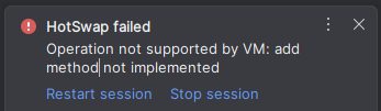

If you use an IDE and debug mode for coding, your ide is connected to the method server.
Each compilation tries to deploy the modification to the vm memory and a change is instantly applied but there are several changes that require file class deploy and restart.
  • Adding a public method in the class
  • Removing a method in the class
  • Renaming a method in the class
All this changes need the restart
With following information the change is applied
With following information restart is needed
