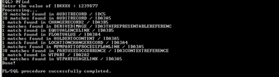

The best way to attack such problem is to run the find_ida2a2.sql with the ida2a2 of an object ,this will return all tables where this id is referenced and relationship columns  .
Attached is the one I use with Oracle .
You may also look at https://www.ptc.com/en/support/article/cs137012
