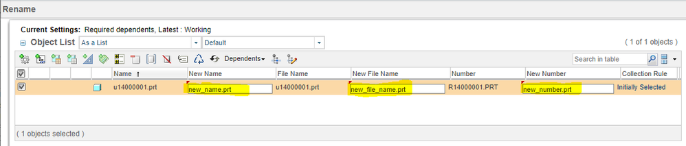

Does anyone know of a way to retrieve the target values a user enters into the rename GUI before any of the rename events finish? We're running into a problem where we can't see what the new filename is until after the number change is already complete. We need to know if the filename is going to be changing, and if so what its new value will be, before we decide whether or not to let the number change proceed. Since separate events are being fired for name, number, and filename, it seems like it's impossible (from just these events) to tell in advace what is going to be changing. Instead of just looking at the object passed by these listeners (EPMDocument, etc.) is there some way to get all the data that was actually submitted by the user on the rename form, before any of the rename events actually finish?
Rename dialog:
Event listener order depending on what is being changed:

@avillanueva wrote:
I have a rename listener and am using a PRE_CHANGE_IDENTITY. Presumably, the target has already been changing but not stored yet.
From the debugging I've done, that second statement is not accurate. Here's what I'm seeing:
Either listener can stop the change, and in the case of a POST event, roll the change back, but neither one provides both the old value and the new value together. From what I can tell, there is no way (just using these listeners) to intelligently compare both the old and new values before letting the change proceed.
I turned on a bunch of other logging, and Windchill clearly know both of these values way before the listeners are fired, but from what I can tell these are not exposed to the listeners.

Both the old and the new values are listed above, before the listeners are ever fired off. Sure seems like we should be able to hook into *something* here…
You were right and I was wrong. The EPMDocumentMasterIdentity class was the difference. I was using EPMDocumentMaster and that only returns existing values but EPMDocumentMasterIdentity does return the new target value prior to the change taking place. Thank you for that.
The problem I'm still having is that EPMDocumentMasterIdentity only returns some of the new values for each listener call. When changing both number and cad name, two separate loops are executed, and as far as I can tell there is no way in the first loop to tell what (if anything) will be changing in the second loop (or if there even will be a second loop).
If a user is attempting to change more than one thing, how do I validate all of the new values that were entered before any of them are changed?
Turning on trace logging for com.ptc.windchill.uwgm.cadx.request.AbstractUwgmRequestAdapter I can see all of the new values. I'd like to have some way to retrieve this information from a supported class when the listener(s) fire off.

From the log information shown above, I can see no way to tell during a cad name change if number is going to also going to be changing. Any ideas?
After scouring the PTC knowledge base, it seems the only supported method for keeping these synchronized is to use a TransactionCommitListener.
