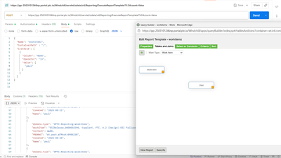

you can make a query builder report to find tasks and run report over rest call
/Windchill/servlet/odata/v4/Reporting/ExecuteReportTemplate
