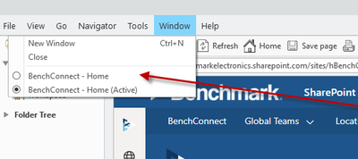

To explain it a little bit more:
The TOP ribbon contains the dropdown menus: FILE  VIEW GO etc.
Just below it there are the TABS: MAIN HOME etc.
Is it possible to customize these?
I have seen already that it is possible to add more tabs:
But I can not find a possibility to add icons or start commands to these additional TABS or toolbars.
Beside of the above I have seen that it is possible to open several Windows:
But when you arrange that you are loosing this when you close the application and start it again.
I hope this is clarifying I little bit where I am looking for.
regards,
Bert

Hi @bbusschers
I'm not sure if there is a simple configuration of the menu in WGM, I've never needed it..
You can check if a WGM Toolkit would be a way how to customize the WGM
Help Center - Windchill Workgroup Manager Client-side Customization
Help Center - Windchill Workgroup Manager Customization
Help Center - Registering a Custom Service
