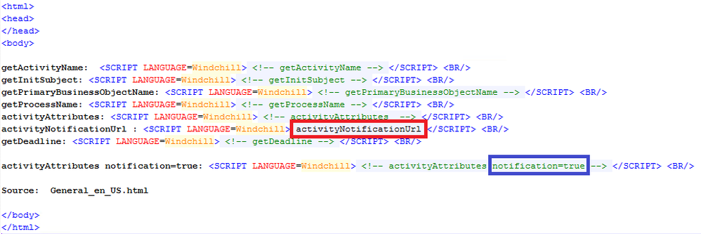

I am working on customizing the workflow task notication templates and have a few questions.
1.)  Why does the activityNoficationURL method not get put in comments but all of the other methods do?  (It will fail if placed in comments.)  [Red Box]
2.)  Where is the extra condition "notification" for activityAttributes documented.  [Blue Box]

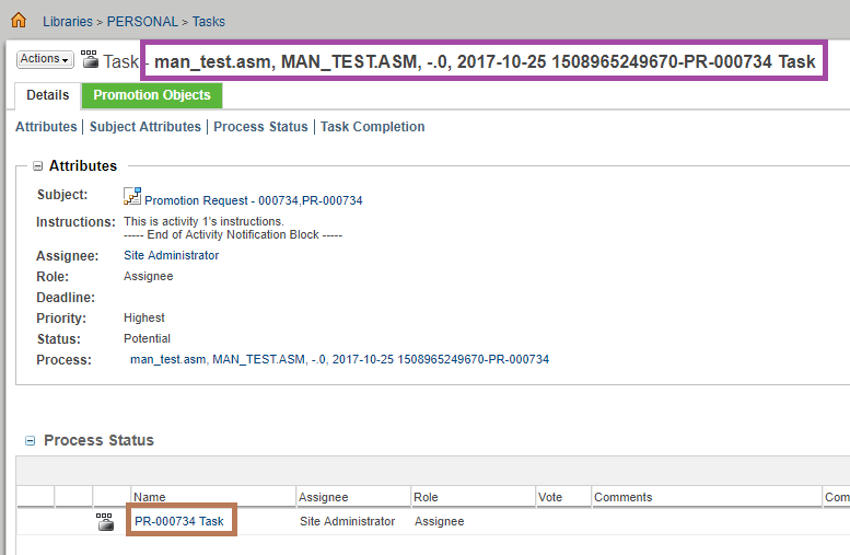

3.)  How do I get just the task URL without all of the extra garbage?  [Orange Boxes]
4.)  Why does the task list the process name instead of the task name?  Is this controlled by a preference?  If not, can the process name itself be changed?  (I'm already dynamically changing the task name.)

Haha, I was about to ask nearly exactly the same questions.
I usually switch to "notification=true" now because it is missing this stupid hyperlink to the workflow process, which is usually confusing the assignee.
What a shame one can't configure the text properly.
But further below that block I put all the really interesting stuff for the customer. Using getActivityVariable varName="messageBody". The variable messageBody can be created in each workflow task differently.
If the variable is not there at all no excpetion is thrown, it is just left blank in the mail.

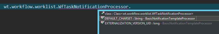

I do, it starting to come back. The class that generates the email is wt.workflow.worklist.WfTaskNotificationProcessor, called out in service.properties files. This has all the methods that the PTC help document specified.  They are all public methods that take in parameters, local and an output stream. They create a string and pass the local, the output stream and the string to a processValues method.
So, if I cannot make do with the OOTB methods, I can extend their class and write my own. I would need to replace their method in the service.properties file and it should run all of the OOTB method plus any custom ones I created.

Thanks for the reply. I'm not really sure about the template processor approach. I've tried to look at the class wt.workflow.worklist.WfTaskNotificationProcessor with Eclipse, but it doesn't expose anything usefull.
No clue where to look for service.properties mentioned by @avillanueva.

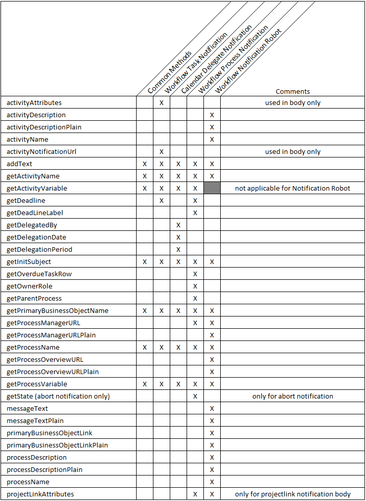

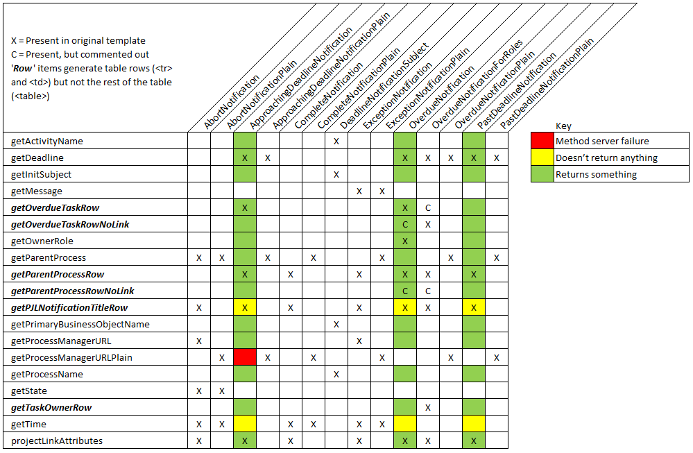

It gets worse.  Some of the variables have to be called together and in a specific order or they don't work.  I went round and round with PTC and asked them to document this but they wouldn't.  They claimed there was no way to create a document generic enough to be relevant to all customers.  Seems like people would want to know why certain methods only work half the time...
Here's a bit of the conversation between the tech and R&D:
Why do we have such behavior?
-->This is the intended behavior as "getDeadline" sets certain values which are being used in "getOverdueTaskRow" and "getOwnerRole"
Are there certain methods that can only be called after other methods are called first?
--> Yes it has to follow this sequence
Any other workaround or solution for the use case?
--> As a workaround please use style="display:none;" property with the first call and then again call this as and when needed without this property.
This probably warrants a separate thread, but I've started putting together a matrix of variables and where they can be used.  This first one is derived from the out of the box email templates and the second is based on the help documentation.
By the way, don't try to use any of the stuff in the "plain" templates.  They aren't used anymore and the calls in them aren't valid.  Article CS293803 was the result of that conversation.
