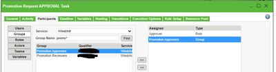

1. Create a group with approvers:
2. Create an Approval task with Approver role:
3. Add the Promotion Approvers group to the resource pool of the Approval task with Approver role:
4. Check the role setup:
You can assign task directly to a group, but it feels more logical for me to work with roles:
