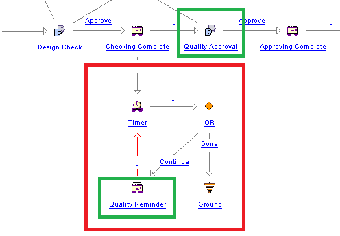

So I built a notification loop in the promotion request workflow to daily remind the assigned individual that they have an open task.  Can anyone offer suggestions on how to retrieve the active task name and corresponding hyperlink so I can include them in the email robot's message text?  The email template for tasks already includes this information but the email template the robot uses is different and does not include this information since it's not tied to a particular task.  How do I retrieve that information?  Thanks.
- Email message for green boxes should be very similar, if not identical.

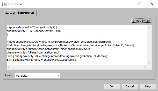

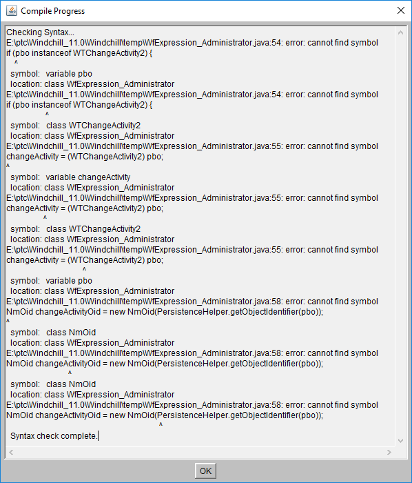

TomU
(To:mcendrowicz)
There must be more to using this than just dropping it in a workflow expression robot...
Can you tell me what else I need to do?
