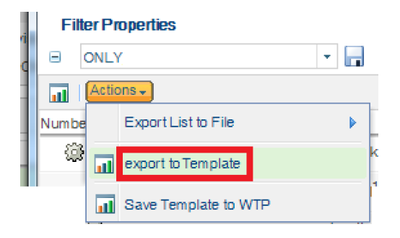

How can I customize below two functionality and I should be able to send email to users which i want (Able to select hardcoded recipient in UI or can be able to add manually if user is not available in hardcoded list).
1) Multi-level BOM report
2)Multi-level Component list report
For Above two requirement kindly find attachement.
Thank you in advance for your comment/suggestion/reply.

In case of document PTC provided email document option as an OOTB functionality.
In this functionality user is able to select recipients as per his need, User is able to add subject and mail body as well.
But my client requirement is similar to like this, they want in case of BOM/Part list.
Kindly find attached picture as a reference.
