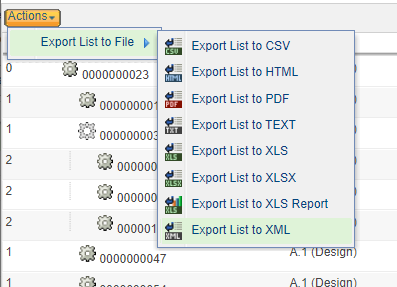

Is it possible to generate Multi level BOM report through API in XML format? We tried using BOMHelper.produceBOMReport(), but its downloading as HTML. We need some help to understand if there is a way to download the report as XML?

I don't think there is a general API to create BOM report as you need.
All exports of MultilevelBOM is done by JSP page from a table menu.
I always write own function to create the BOM output in any format I need it.. (xml, csv, html, txt)
It is not so complicated to collect all levels of BOM.
You can also build your xml format as you need.
I know it doesn't help too much. May be somebody else knows the API which could help.

Hi PetrH,
This approach worked out. I have used a recursive loop to get all levels of BOM.
Thank you very much!
