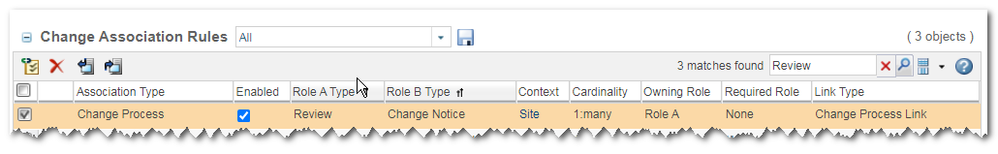

rhart
(To:slapha)
Change Tasks can only exist in a Change Notice.
You can create a Change Association Rule between Review and Change Notice, then you can link Change Tasks to Reviews via Change Notice.
Review - > Change Notice - > Change Tasks

slapha
(To:rhart)
This is how it works today OOTB. Though if your review is based on the Change Task, not the Change Notice there is a disconnect.
I'll admit this is a bit of "how we do business" not how PTC has set up things OOTB.
