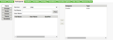

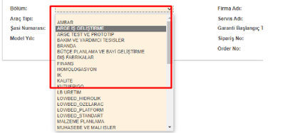

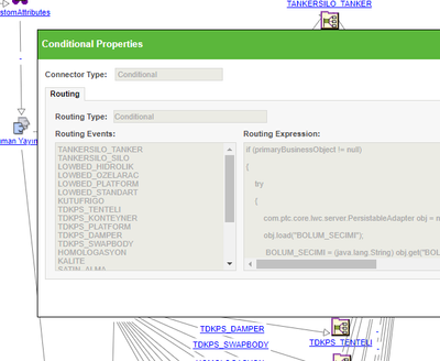

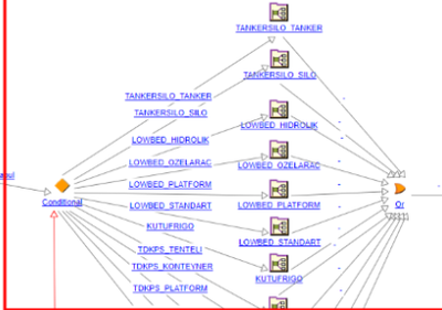

hello, I have a workflow and in this workflow, the flow goes to different parts according to the values ​​in the global enumeration in the attribute in a particular layout. In fact, I make users choose a section, and as a result, the flow progresses according to the selected section.
The problem is that I do this for each partition and I have 30 partitions in total. which means task and etc required for 30 sections.
How should I use something here so that the participant I selected directly finds the role or group in the enumeration?

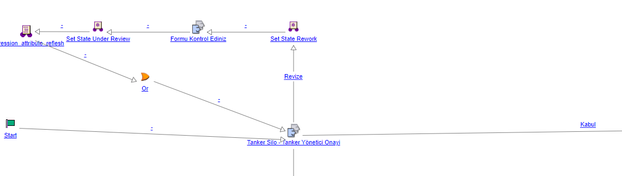

Can you explain better? I loathe these fanned workflows for this reason. What happens in each sub-workflow block you show there?
Hello avillanueva,
sorry for my late reply,

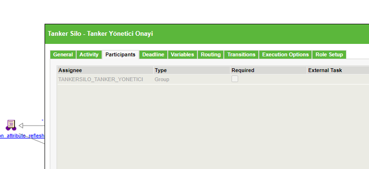

there is only task inside the blocks. I'm sending a task to a user whose name I just specified. For example "tanker silo manager".
Maybe it would be cleaner the write an expression to add the group into the role, instead of all those blocks.

What does submitter do?
I can direct the flow according to the section selections entered by the users, but when I want to send the tasks to the necessary people, I have to choose a separate participant for each section, which intensifies the flow. Is there any way I can do this problem in a single domain?
I can select participants according to the section selected below, but I need to create another one for a different section.
In my case the Submitter is the Role name for the user who submitted something for a review.
You can assign the task to always the same Role, the expression I shared above shows how to add a principal into the Role.
