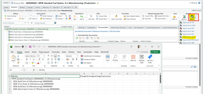

Bonjour Monsieur Cadiou,
Veuillez vous referrer a la capture d'ecran .
Fede
avillanueva
23-Emerald I
(To:Fadel)
Great insight @Fadel . Now that I see what you were talking about (love screenshots), note that the View option on the menu will allow you to customize the columns that are displayed and then exported. You can create your own custom view names, toggle them to change the output of the resulting Excel.
