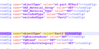

I am using Windchill PDMLink Release 12.0 and Datecode with CPS 12.0.0.3
Business Rule- Attribute validation Configurationt
Example :
Set of Attribute -Subtype of Part1
Set of Attribute- Subtype of Part2
How to Load the Business Rule For these Case
You need to create different rules for each subtype
Rule1 for objectType = wt.part.WTPart with excludedType=<domain>.subtype1 and 2
Rule2 for objectType = <domain>.subtype1
Rule3 for objectType = <domain>.subtype2
Load those rules in to one or multiple rule sets.

Using Attribute Rule ,We Can Configure for Particular Part.
But My Requirement like,
Need to configure  Multiple Subtype with different Attribute.
