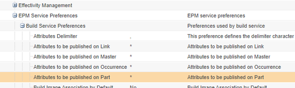

Also check your preference configuration
Attributes to be published on Part  * asterisk is default value and it means all defined attributes
