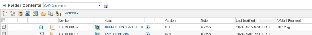

@khimani_mohiki Thanks for your response. I figured out a way with a calculated attribute.
Let's say we have the Attribute WEIGHT synchronised from the PRO_MP_MASS
You can create a calculated attribute called e.g. WEIGHT_ROUNDED. The unit must be the same as on the WEIGHT attribute!
The formula for this attribute would be: execute("ch.bmr.core.businessfield.RoundNumberWithUnits",WEIGHT)

Unfortunately the calculated attribute can't be shown in the workspace. But on all other places (info page, tables) the value is being shown correctly.
We're hiding the original WEIGHT attribute and are only showing the calculated one.
Example of the WEIGHT and WEIGHT_ROUNDED attribute on the info page.
