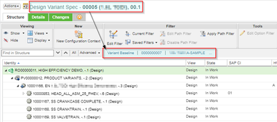

We are thinking about using com.ptc.wpcfg.doc.VariantSpec for our BOMs which should be transfered to other ERP Systems. the easist way would be the use of the OOTB RestAPI EndPoints.
Can i use it (and if yes how) in the VariantSpec Criteria in the API Call? When i just passed it in there was an error.

The com.ptc.wpcfg.doc.VariantSpec (Variant spec) , is just an advanced filter with some ATO parameters.
This filter is then applied to a Configurable Bom to generate a Variant BOM .
I'm not sure about what you need publish to ERP .
Fede
this is the bom we need to transfer to the ERP System. At the Moment, we are using Serial Effectivity as Navigation Criteria for our BOMs with transfer but we change to the Variant BOM
@ElmarBrauchart
Check the PTC.ProdPlatformMgmt - :443/Windchill/servlet/odata/v3/ProdPlatformMgmt
