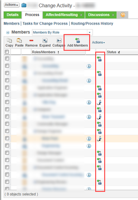

Do these roles have Modify Identity available to them?  I am going through the same thing with another area of the interface. I have an open support call and am waiting to hear back.  But it seems that ACLs might override them all.

I got a reply back today from PTC Tech Support that I had to "deny" the roles for Team.  However I have a customized interface for creating changes that needs to have that set to be able to create the notice and task.  I wrote back to them that logic was backwards and that if the ACLs controlled it, then this other was useless.  Profiles and Configuring Actions for Roles should override the ACL.  The ACL just says if it is doable or not.
I am interested in what PTC has to say on why this is so.

Hello @Fadel  I have configured my profile and these are still showing up.  The Teams definition in the ACL is overriding everything.  Support told me that I needed to Deny Modify at the ACL level for Teams.  This then bypasses what is in the profile.  I believe that UI instructions should override ACL and not the other way around.
