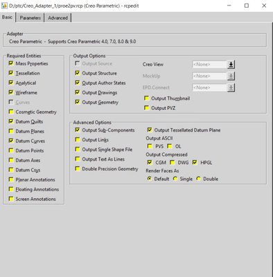

Thanks! Here is how the rcp file look like:
Open rcp file in text editor and look for this line:
adapter/serverVersion=1120
Yeah, it there. Here are the contents:
file=proe2pv-rcp
ver=5
lastp=conv
adapter/useTransparency=0
adapter/workerRestartInLocale=1
adapter/useTexture=0
adapter/pdfFontControl=1
adapter/pdfColorControl=2
adapter/pdfUsePenTable=1
adapter/proeCommand=C:\/Program Files\/PTC\/Creo 8.0.3.0\/Parametric\/bin\/parametric.bat
adapter/exitCommandCount=5

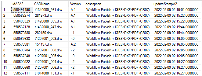

Yeah, I had to roll back too and then find and republish every DXF generated since I moved to 8.1.  Fortunately my publish rules include the word 'DXF' in the representation description, so it was pretty easy to locate them in the database and then feed to corresponding idA2A2 values into the CSV mass republish script PTC makes available.  (See section 2 of CS211115.)
select
	ed.idA2A2,
	edm.CADName,
	concat(concat (ed.versionIdA2versionInfo,'.'),ed.iterationIdA2iterationInfo) AS [Version],
	di.description,
	di.updateStampA2
from
	DerivedImage as [di]
	join EPMDocument as [ed]
		 on di.idA3theRepresentableReferenc = ed.idA2A2
	join EPMDocumentMaster as [edm]
		on ed.idA3masterReference = edm.idA2A2
where
	di.classnamekeytheRepresentable = 'wt.epm.EPMDocument'
	and edm.authoringApplication = 'PROE'
	and edm.docType = 'CADDRAWING'
	and di.description like '%DXF%'
	and di.updateStampA2 > convert(datetime, '2022-02-01')
order by
	di.updateStampA2
