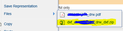

DXF Export comes with zip
I am using Windchill PDMLink Release 11.1 and Datecode with CPS M020
intf2d_out_generate_log_file has no effect while exporting DRW to DXF, it creates log file and in representation dxf is zipped.
I need to have single dxf file in additional file list instead of dxf_XXXX.zip

Yes issue is generic with all drawings where it creates dxf file and its output log file which gets zip and shown in Additional Files as shown below

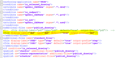

Yes I am using custom publishing rule as below

Thanks Mr Jones, I was using Creo Adapter 7.1 and after installing 8.1 issue is resolved. Thanks a lot and have a great day.
